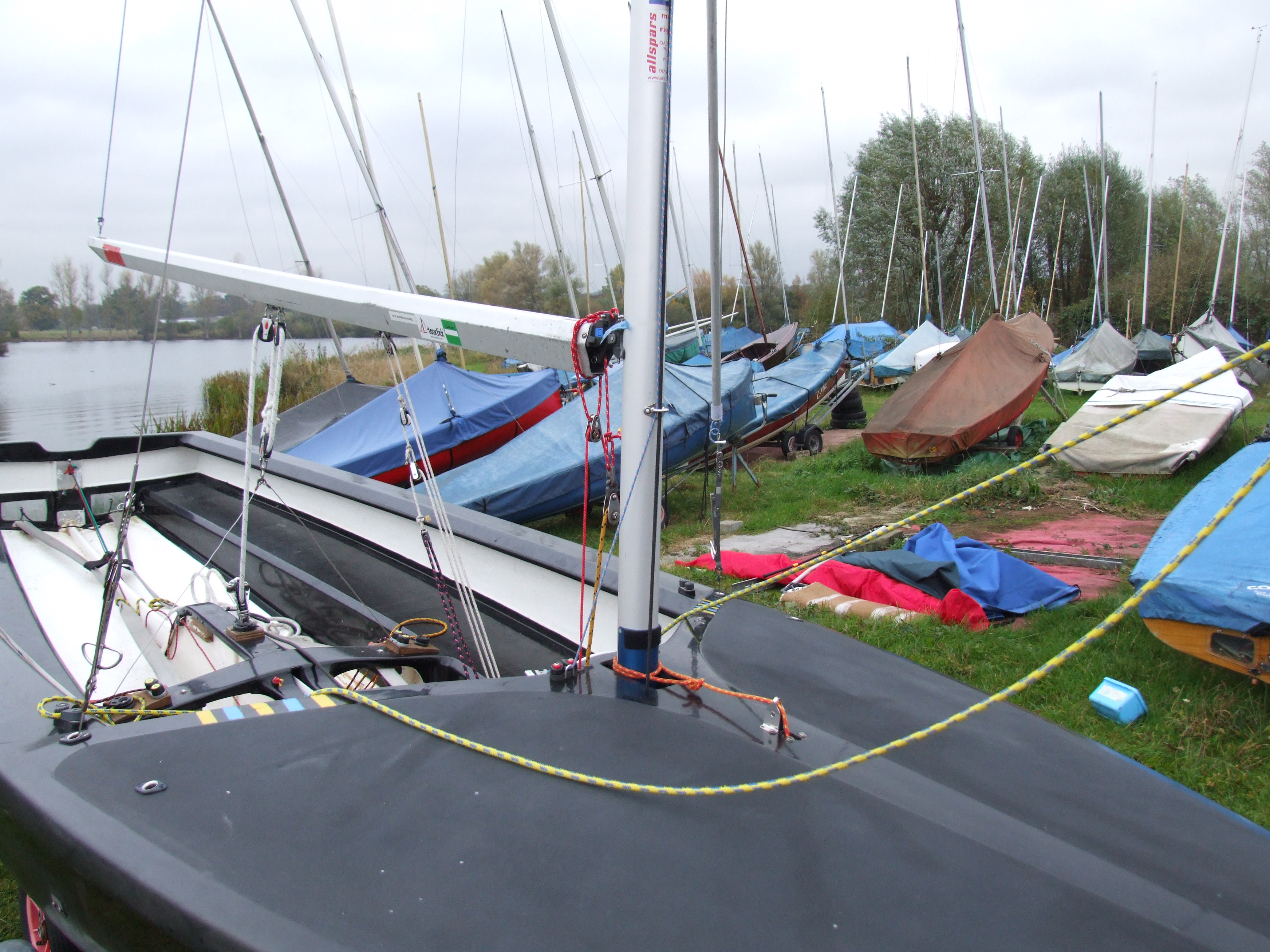

On Blackadder (AL6490) I made my own pole from tube from the local hardware store. The pole diameter was about 20mm but It was slightly thicker gauge that that found on 25mm poles. it worked well with no bending problems. The set up was pretty much as described in Trevor's article (I used his boat as my guide).
The Speed set up uses 25mm pole. The standard offering uses a guide line on the inboard end. But I have taken it off and it is now infinitely better. To answer Ian, the reasons I took the line of are as follows (in order or importance)
1) Grumpy wife complained that there was too much friction in the system and it was difficult to deploy the pole - It is now much much better without the guide and I am back in her good books.
2) The line on the mast holds the pole end near the mast, which sounds sensible at first, however the effect of this is to angle the pole down more which puts too much tension on the leach of the sail when on a broad-reach or run and causes the jib leach to hook. See pic here
3) For the reasons given in 2 the pole sets better on a beam reach with the pole used to control the jib leach. Even with the inboard end of the pole controlled by bungee, it is very stable. See pic here .
There is no need to use a shorter pole on the reaches as the pole's effective length is reduced as it goes up the mast. Therefore make your dangly pole maximum allowed length.

John thanks for all the info and particularly on the Speed system. I have spoken to them and they will supply a fly away kit to order at a not too ridiculous price. As you have removed the fixed guide rope on the Speed system and I can see how it makes sense from your pics are there any other mods you would suggest. As I will be ordering a one-off I can pretty much say what goes in to the kit. What do you favour for the bottom pulley and cleat arrangement for the control line? Is yours deck mounted? Hope to get up to Maidenhead sometime this Spring so may be an opportunity to see some of the albs in action if not join in ,
I kept things simple. I dont bother with a bottom pulley, on Blackadder I simply used the mast fitting that was there for the old pole. The cleat is deck mounted and bolted through. Photo here The thin blue line controls the pole, the black retracting bungy goes down to the foot of the mast and then back up to a cleat at deck level. This differs from the speed system where the bungy goes down the mast to the lower loop position and then back up to the top pulley. I discussed the reason for this approach with Speed - they said if the bungy went down to the bottom of the mast it would snag on the strut fitting on the mast - which makes sense if you have a strut.

And finally - I have purchased a 'kit' from Speed . They were very helpful and put this together at my request based on their production model as on John's boat. Be mindful that you must have an aluminium pole to conform with class regs. Speed now have the kit listed in their latest catalogue - no I didn't get a discount for this plug. Seriously though it has taken most of the agro out of the conversion to fly-away pole together with the photos I took of John's boat at the dinghy show! You could do the conversion cheaper if you convert your own pole and get it right first time. Hope this helps anyone else wanting to make the conversion,
