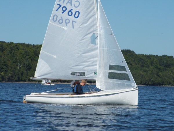

Laminate Sails 56 years 3 months ago #7090
Warner has sent me this pic of a laminate Jib:
It was built as part of the dual window trials. His comments are as follows:
- photos are at www.waverate.com/images/DSCF4915.JPG ,
- there are more images through DSCF4927.JPG with a couple of exceptions,
- we took a bit of time in the summer of 2008 to play around with different windows and materials,
- the Dacron sails were Dimension/Polyant HTP Plus 165g/m^2,
- the Laminated sails were Dimension/Polyant PEN (Mylar film / scrim / scrim / Mylar film taffeta),
- PEN is the same material we used in Snipe jibs,
- we tried plain 5mil Polyester Monofilm but ended up preferring the 5mil Polyester Monofilm with X-Ply,
- sails were comparable,
- costs were comparable, and
- Laminated sails need leeches re-cut because they didn't stretch the same as the Dacron.
